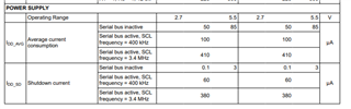

    I would not recommend using our device in this way. Please follow the recommend voltage range to power up the device. If you are looking to save power, you can put the device in Shutdown mode. When the device is in shutdown mode, writing 1 to the OS bit starts a single temperature conversion. The device returns to the shutdown state at the completion of the single conversion. This is mentioned in section 7.4.1 and 7.4.2 in the datasheet. As you see below, you can save more power with shutdown current.
