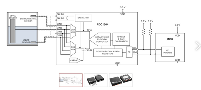

I would like to monitor the ink capacity in the glass jar, did the FDC1004 Is a right solution?
HI sir
Alex,
The FDC1004 is the best capacitive sensor for liquid level sensing.
You can find a comprehensive list of app notes, etc. at the E2E FDC1004 Frequently Asked Questions page.
Some of the app notes about liquid level sensing:
I hope this helps.
Please let me know if you have any questions.
