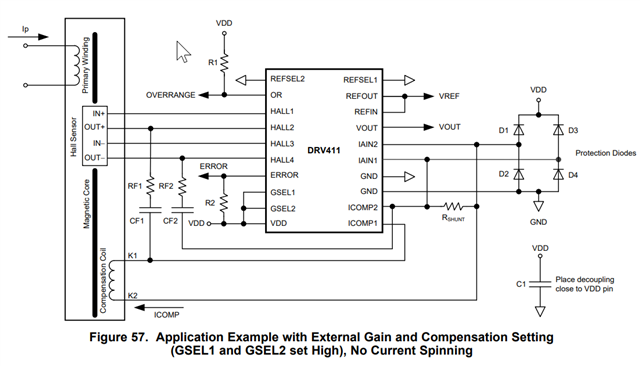

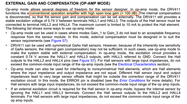

Our sensor is currently operating in Op-amp mode.
So, I have some questions:
1) Could you please let me know what the default gain is when no external components are connected?
2) How should I set the resistors and capacitors to achieve the desired gain?
