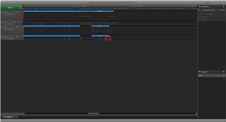

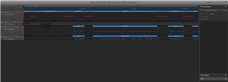

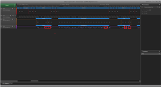

I faced some issues during boundary scan testing implementation in our I3070 ICT machine.
It looks like the available BSLD file is outdated on the website. I read Version Number 0010 instead of 0001 from the device, and it looks like that the INSTRUCTION_CAPTURE values may also have changed.
Can you please send directly to me or update the BSDL on the website?
