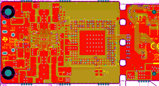

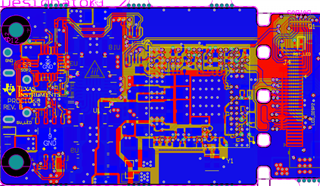

I have checked out the AWR1843AOP PCB layout but cannot see the Tx and Rx antennas (patches?) in either the top (red) or bottom (blue) layers.
Are they embedded into the chip, or where are they located?

Correct, the antenna is integrated within the package. For more info, please refer to the following app note. How AoP technology expands radar sensor placement for automotive applications
For the coordinates, please refer to the following thread, AWR1843AOP: About feeding position - Sensors forum - Sensors - TI E2E support forums
