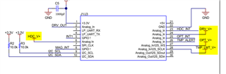

When connected to your Arduino, you have not supplied power to the sensors. See the schematic in the user's guide. https://www.ti.com/lit/slau829

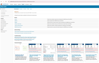

Also, it is a plug in module, which I connected with F28379D Launchpad but was not able to test the C2000 example provided by MathWorks.
https://www.mathworks.com/help/releases/R2024b/ti-c2000/sensors.html
It would be helpful if you gave me any working example that this sensor module (BP-BASSENSORSMKII) works with the F28379D launchpad either in CCS or Matlab.

I see now what happened here. The software for this BoosterPack was broken by an update and removed from the web instead of updating it. https://e2e.ti.com/support/sensors-group/sensors/f/sensors-forum/1068261/bp-bassensorsmkii-gui-composer-v2-example-for-bp-bassensorsmkii That means there is no example code for this BoosterPack.
At any rate, my previous point still stands. You will have to activate the GPIOs highlighted in yellow to power the sensors on this BoosterPack. That is just a fact of the PCB design. There's no point in arguing whether the design is right or wrong, because I don't disagree with you.
