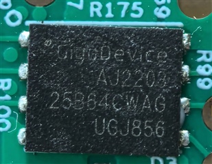

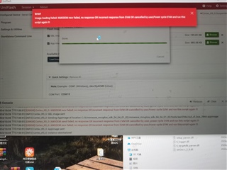

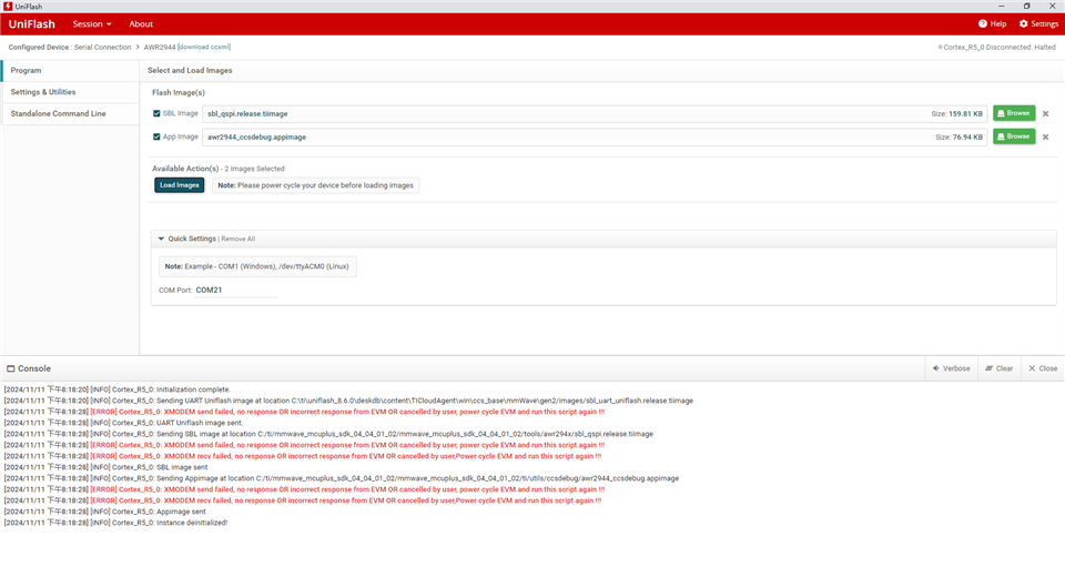

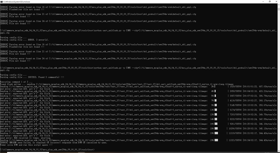

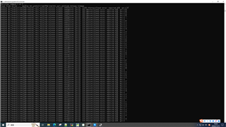

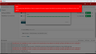

Hi designer,
  I have some problems when using uniflash to flash appimage into the board, it gets stuck in the state of initalization complete or Flash. We have tried lots of ways to solve it, but no sense.There are some questions below we find.
  1. Under the condtion of SOP of 101, when 2944 rx recevie data, is there any response from 2944 tx to computer. Besides if there was response, would it happen before flashing into QSPI?
  2. voltage of SOP4 in AWR2944EVM is 3.3V, but 1V in our board. Is it OK?
