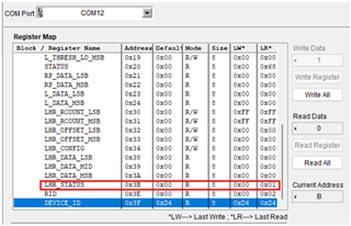

I wanted to check something I think is an undocumented behavior with TI.  We configure the LDC1101 to generate an interrupt when the conversion is ready.  As a power optimization, we tried to put the sensor into sleep mode as soon as we got the interrupt.  The thinking was that we could immediately stop driving the coil while we wait for our SPI transactions to  read out the conversion data.  This might save a little bit of power.
When we read the 0x3B register after entering sleep mode, we see a value of 0x01, which means LHR Data not ready.  This disagrees with the signal from the interrupt, which told us that LHR data was ready, just before we entered sleep mode.
Is there an explanation for this behavior?  Is entering sleep mode causing the LDC to retain its "configuration" registers, but clear its "conversion data" & "Status" registers?

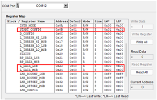

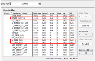

    Turns out I overlooked something yesterday and could test with the EVM. Per the tests I conducted today, it looks like I am getting similar behavior to what you observed.  My test consisted of the steps below.  Per your test and mine, it looks like data registers are cleared when sleep mode is entered and the status register updates to confirm that data is no longer valid.
    1. Open the Register Configuration tab in the EVM gui
    2. Set register 0x0B (START_CONFIG) bit0 to 0 to put the device in active conversion mode to gather a measurement then write.
    3. Read All.
    4. Verify registers 0x23 and 0x24 show some sort of nonzero value.
    5. Set register 0x0B (START_CONFIG) bit0 to 1 to put the device in sleep mode and write.
    6. Read All.
    7. Look at 0x23, 0x24, 0x3B contents.

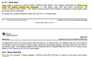

    Thank you for investigating.  I did review the datasheet and it seems to claim the register contents are maintained in Sleep mode.
    It sounds like you and I are both seeing differently.  Will you be able to confirm with the design team if this is a bug?

    One of the digital designer's confirmed the behavior we both observed is to be expected.  Looks like a typo or important word may have been left out that clarifies what type of registers are preserved.
