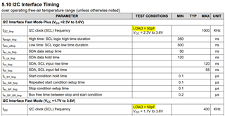

In the datasheet, it is not specified which input capacitance have the I2C TMAG5273 sensor pin.
Hi Kenneth,
Thank you for posting to the Sensors forum!
While the datasheet does not clearly state the I2C pin capacitance, it does specify a capacitive load of 50pF when specifying the I2C frequency.
Hopefully this helps.
