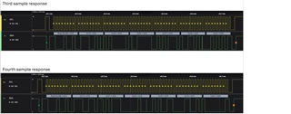

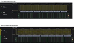

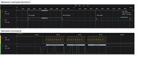

    I have captured the I2C communication and attached screenshots of the communication and saleae log file (Temperature I2C comm.rar).
    As you can see there are 4 sensor samples every 1min.

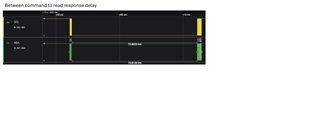

    The temperature reading command is: 0x2400, trigger on demand.
    After each temperature reading command, there is 20ms delay (see screenshot) and only after it we read the result.
    Immediately after the first sample, I turned on a heater, and expected that the temperature increase.
    But the temperature remained constant for the second sample and changed only in third sample.
    Here is a table of the sensor response values with the converted values:
    Sample No. Byte 0 Byte 1 Reported Temperature
    1 65 4 24.0547036
    2 65 0C 24.0760662
    3 72 A0 33.3581292
    4 73 D7 34.1886015

    I would try and repeat the transactions with SCL released high during the 20ms conversion time, HDC3020 does not clock stretch but some similar devices do. I would see how the linked code from ASC studio works for you and if you still see the issue.
    Have you tried this on multiple devices, and with a faster sampling rate? Do you see this issue no matter how frequently you query for data?
