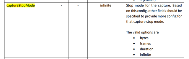

    2) How did you program the 20s of the capture time?   I know not all the captureStopMode in json file are actively supported in the DCA1000 CLI command. I usually use "infinite" mode and send a command below to stop capture.
    DCA1000EVM_CLI_Control.exe stop_record xxx.json
