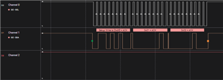

    I did a scope shot of the i2c bus during initialization, here`s how it looks like
    (the device config 2 is the last register written)
    i2c communication
    My understanding is that when I put the device to sleep and wake it up with this configuration, it should interrupt the pin !INT when the threshold is crossed once and then will be in stand by mode.
    I don`t see any interrupt triggering.
    When I change the device mode to continuous mode the interrupt triggers as expected when i bring the magnet close

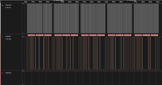

  • Hello Patrick,
    Sorry for the late response.
    I got this new scope shots for clarifying this issue.
    This is the configuration i used to set the device in sleep and wake. On channel 2 I added the INT pin.

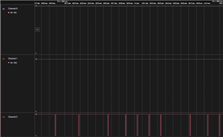

    When I configured the sensor in continuous mode with the following commands I get the interrupt when i approach the magnet
    Here`s the INT pin when i approached the magnet.
    I have a custom board with the tmag sensor. I tried out three different boards and all of them seems to have the same issue.

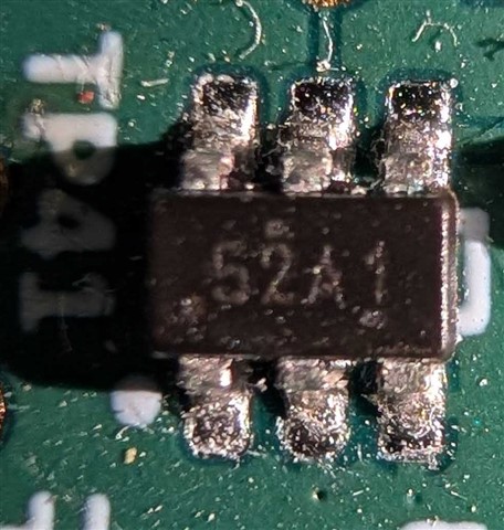

    Here`s the marking on the sensor:
  • Hello Rodrigo,
    Which version of the analog discovery did you use and what version of the software?  For my version, you would not be able to run protocols and logic simultaneously.  Your waveforms screenshot suggests that you are providing the communication from somewhere else.  The analog discovery has >3ms pauses between each register write with that script as you can see from my figure below.  Please try that script per the second figure below and monitor with saleae's Logic program.  Once we confirm you
    Date code indicates yours was made January 2024 while mine was made December 2023.  I would expect similar behavior between the two devices.  Can you provide the purchase information from the ESD bag label or shipping box label?

    I re-checked the commands using a Saleae Logic 8 Pro and the Logic 2 software (version 2.4.14).
    This is how it looks the sleep and wake configuration.
    Again i approached the magnet and i did not trigger the interrupt ( on channel 2 ).
