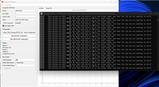

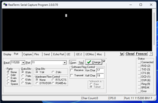

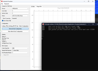

    Additionally, after reinserting the device, I’ve attached the following screenshots in Functional Mode(I also tried pressing Enter a few times in terminal):
    1. The screen when only connected to Realterm (without connection to the Visualizer).
    2. The screen when only connected to the Visualizer.

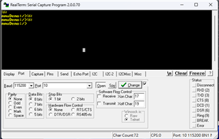

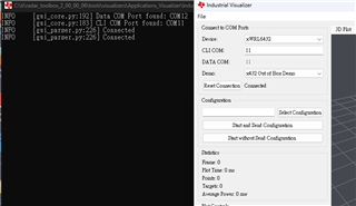

    I also tested the 6843 on hand, and under the same steps, I got the following results.
