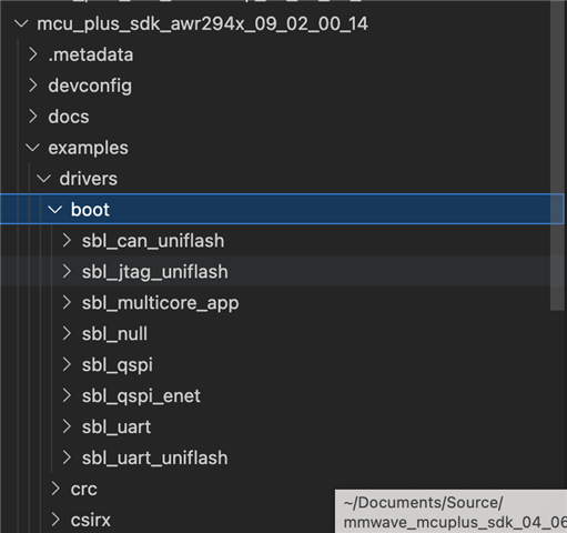

    Then you will have to modify the syscfg in the application of the uart_uniflash and qspi to support it.
    Also, from your log it looks like the bootloader was received and started executing. When you get the error, you can connect to the R5 core over CCS and load the symbol of the UART bootloader and check where it is stuck. Then it should be possible for you to debug where it is going wrong.
