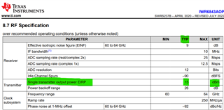

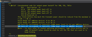

  I have noticed a discrepancy in the Tx antenna output power specifications for IWR6843AOP. The IWR6843AOP datasheet lists the output power as 15dBm, while the mmWave SDK documentation states it as 13dBm (see "\mmwave_sdk_03_06_02_00-LTS\packages\ti\control\mmwavelink\include\rl_sensor.h" LINE 683). Could you please clarify the reason for this difference?
