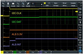

  • Hi Daniel,
    This is Dilbert from Garmin platform software division.
    Nice to meet you.
    We've some waveform that show odd timing as below.
    According to the above waveform, we found that after 0x44 slave address sent, there is a time gap which keeps 42ms low then just send 1st byte data out.
    Could you tell me in what situation ALS pull SCL to low for 42ms? [Notice]: the issue happened after that.
    BTW, we also would like to know the power on timing after power on that is when could host send first command to ALS after power on?
    Because we're afraid that host sent command so early that ALS isn't able to work.
    Thanks a lot.
    Dilbert Kuo

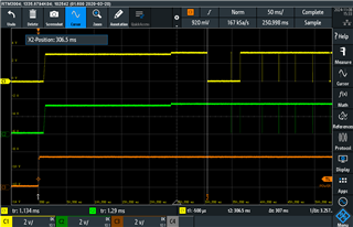

    Also, have you increased the time between power on and when you start communication with the device to verify whether or not its an issue with the power on timing?
    [Dilbert] In below waveform, orange signal indicates power, yellow signal indicates SCL signal. As you see, after power on, the first command is sent after 306ms. I think the time slot should be enough for ALS internal initialization.
    Is there any situation in which it makes ALS pull SCL low?
    Thanks a lot.
    Dilbert Kuo
  • Hey Dilbert,
    Ideally, the device should come on within a few ms after ramp up. This 306ms window should be more then enough time to receive I2C commands, as you have already mentioned.
    After this initial time out period, I see that SCL line eventually pulls high. Are you able to write the configuration and then read from the device after the line is released? Are all units having this same behavior? Does this occur every single time this device is powered on or is this a one time instance? Could you provide a percent estimate of how often this occurs?
    The initial transaction from your previous message looks good, I don't see any reason why the device could be pulling the line low. Could you zoom in closer to that initial SDA and SCL transaction?

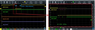

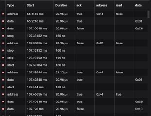

    The failure rate is around 10%, and as shown in the picture below, the issue occurs when only the I2C clock (CLK) is pulled low. We also used a logic analyzer (LA) to monitor the I2C, as shown below.
    Normal device power on:
    Failed device power on:
    LA record failed device:
    Now, we found a recovery mechanism, when we observed ALS always return CRF 0, we try to resend the conversion mode command. After that ALS will be able to work normally.
    Do you have any idea why resend the conversion mode command can resolve this issue?
    Thanks a lot.
    Dilbert Kuo
  • Hi Dilbert,
    No worries, let me run this through the design team to see what could possibly be causing this issue on the SCL. I would not expect this line to be pulled low after power on.
    Daniel
  • Hi Dilbert,
    The SCL of our OPT devices are input only, meaning that the device itself is not capable of changing the voltage level of the line. Only the I2C host is capable of doing this.
