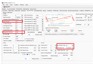

AWR1843BOOST: Seeking guidance on the mmWave Studio configuration for collecting high-speed vehicle data using the AWR1843 and DCA1000.
Part Number: AWR1843BOOST
Other Parts Discussed in Thread: AWR1843
When using the AWR1843 and DCA1000 to collect data on high-speed vehicles (traveling above 60 km/h) in a road test, what would be the recommended range for the following configuration parameters in mmWave Studio?
  • Idle Time:
  • Ramp End Time:
  • Periodicity:
  • Number of Chirp Loops:
With the 3Tx4Rx configuration on the AWR1843,
Please give me some advice on these highlighted parameters in the context of my proposed detection scenario.(The mmWave radar is positioned for road testing, facing the side of vehicles traveling at speeds between 60 km/h -- 100 km/h.)
It would be great if you could explain the meaning behind the parameter settings!
