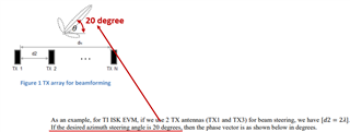

I checked beamforming In Lrpd document.
I'd like to know what does "steering angle" mean?
Take below chart as the example, is Red angle(20 degree) is the "steering angle" ?

Hello Bruce.
That is correct; the steering angle is the angle at which the beam strength is the strongest.

Hi Santosh,
xWR6843 with TX beamforming, it's in the shape of a cone with a 22.5 degree angle to boresight.
Why is 22.5 degree angle?

Hello Bruce.
I assume you are talking about the long range people detection beamforming configuration, and I believe it is set to 22.5 because it wants to cover 90 degrees and with 4 subframes you change the angle by 22.5 degrees to cover 90 degrees(+/- 45 degrees from boresight). Please correct me if I am referring to the incorrect demo or reference material.

Hi Santosh,
Yes, I see 22.5 degree cone in the Long Range People Detection demo.
I'd like to know if 22.5 degree cone is fixed for xWR6843, so it set Angle Step Size to 22.5 degrees.
I see another example, it also set Angle Step Size to 22.5 degrees. Angle Step Size to focus on the angle of [-33.75 -11.25 11.25 33.75]
if 22.5 degree cone is fixed for xWR6843, then I need to set Angle Step Size to 22.5 degrees even different angle to cover.

Hello.
I think its set via the txPhaseShifter and by changing that value you can change the sweep angle if the other parameters are kept the same.

Hi Santosh,
Per "Long Range People Detection User Guide", I get phaseShift.py to calculate phase shift values.
Do you mean if the cover range is [-20, 0, 20], thetas is 20 degrees.
Then I set txPhaseShifter and the shape of a cone will be 20 degrees. Right?

Hello Bruce.
We may be saying the same thing differently here, but once you set the txPhaseShifter on each subframe it will point the cone at 20 degrees, then 0 degrees, then -20 degrees.
