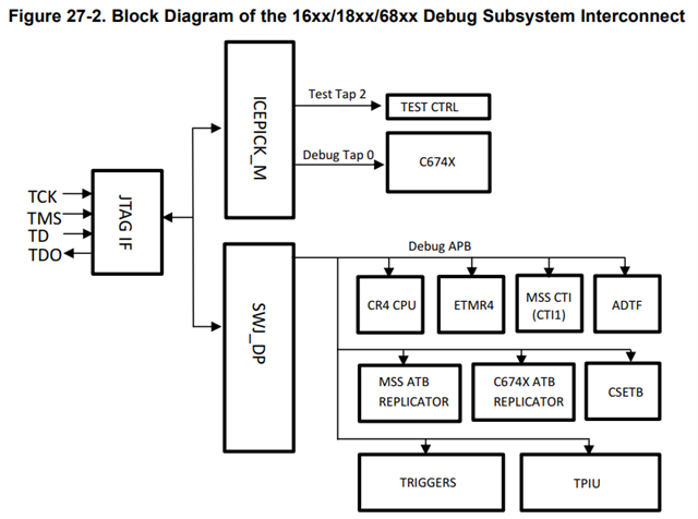

Good morning,
I'm using the IWR1843 Boost and require guidance on communicating with the IcePick JTAG module via OpenOCD. The IcePick version is IcePick_M.
As I understand, each core (R4F, C67x) has a separate JTAG Route Controller (JRC) index, and I need to know these, in order to add the cores to the JTAG chain. So I first question is, where can I find this information?
