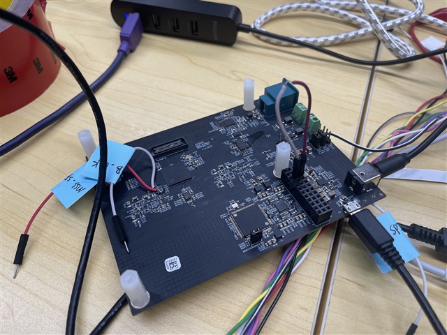

I have a TIDA-020047 and it can't download appimage correctly.

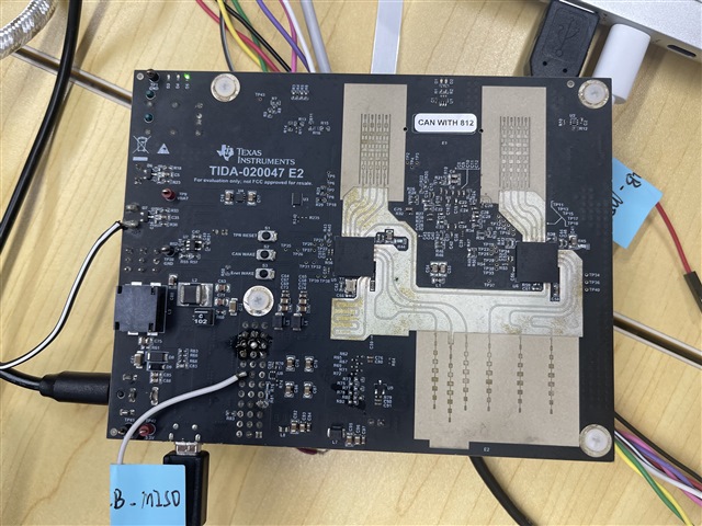

  • Hi Zorah,
    In the forth picture, I have add a 1k resistance to disable WDT. And the jumper is moved to FLASH. But we can't download the appimage. And only D5 LED is working when the board is connected to power. What is the next step for debug?
    Shawn

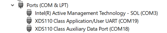

  • What power supply are you using? Please make sure it is 12V. Also please make sure the COM port is updated correctly
  • Zorah,
    The power is 12V and COM port has been updated. You can see the first pic.
  • Hi Zorah,
    I have tested the output of LP876242, the 3.3V, 1.8V, 1.2V and 1.0V A are all normally. 1.0V B doesn't have output. For this buck, it should work after the appimage is downloaded and run. Need you to give us next debug step.
    Shawn
  • If you have tested the above debug steps and it still doesn't work, it means the board is broken. Please try on a different 2 chip cascade board
