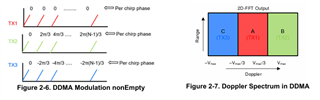

I am currently working on operating DDMA under the following environment:
Hardware: AWR2944 EVM + DCA1000 EVM
Software: mmWave Studio 3.1.1.0 + mmwave_mcuplus_sdk_04_05_00_02
I have some questions regarding the High-End Corner Radar Reference Design.
(www.ti.com/.../tiduf01.pdf
In Figure 2-6, it explains about Tx1, Tx2, and Tx3.
Could you please confirm if the correct order for the settings in mmWave Studio is Tx0, Tx2, Tx3?
Thank you very much for your assistance.

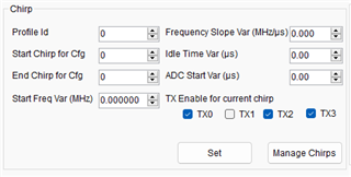

  • Hi Jason,
    Please check the Tx order in the below screenshot. Tx you have enabled corresponds to Azimuth antennas that are in same plane.
    For DDM processing chain implemented in the SDK, I suggest you check "C:\ti\mmwave_mcuplus_sdk_04_06_01_02\mmwave_mcuplus_sdk_04_06_01_02\docs\mmwave_sdk_module_documentation.html".
