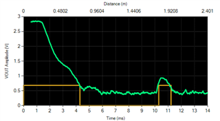

    I had one on the shape of the output and from the description in the datasheet the receive signal went through a pre-amp, a filter, the logamp then the output buffer. There was no mention of detectors in the logamp stages or other method to recuperate the RSSI (envelop of the signal) which seems to indicate that the output is basically the amplified oscillations of the received signal. However I found in one of the post that you mentioned the output is the envelop.
    Another related question is on the filter which seems to be between the output of the logamp and the output buffer and the associated external capacitor on the FLT pin. I'm trying to understand what does that filter actually do. Is it just a low pass filter? What does the FLT capacitor actually do?
    Also the equation on Vout is confusing, specifically within the log section. The units don't add up. Glna and Gbpf have no units, Vin is in volts, INTlog is in dBv and Kx has no units. So you end up with Volts/dB for which you take the log. My guess was to convert the INTlog in volts to get the units to line up, however the results don't match the curve. What am I missing?
    The purpose of these questions is to understand what will affect the shape of the Vout curve and how, based on the type of signal received.

    Regarding your question on the envelope of the signal, the TUSS4470 does not provide the amplified oscillations on the output but it does provide the envelope of the signal. Output example captured over ADC:

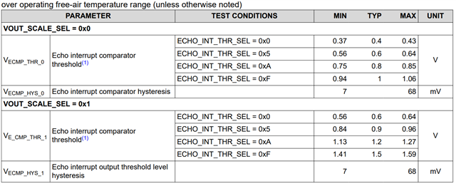

    I went through the various registers and have a few questions.
    DEV_CTRL_1: LOGAMP_SLOPE_ADJ
    The equations are missing some explanations. I assumed for VOUT_SCALE_SEL  that if the parameter was set for 3.3V in the equations you use 5V for VOUT_SCALE_SEL with a bar on top and 3.3V with no bar. For VOUT_SCALE_SEL at 3.3V this results for LOGAMP_SLOPE_ADJ from 0 to 7 in 30.048, 31.043, 32.038, 33.033, 26.002, 27.030, 28.025, and 29.020. I checked the numbers against the slope of Figure 6-13 and it matches. It's also in line with the non adjusted slope SLafe of 29.7 (Section 6.7). If these results are correct, it implies the units are wrong at the end of the equations. The slope is linear when the input voltage is expressed in dB so the units are mV/dB which is what is also used to specify the non adjusted slope SLafe.
    The problem is that it doesn't work if VOUT_SCALE_SEL is 5V. The results are around 32mV/dB whereas they should be around 45mV/dB. Am I making the wrong assumption in the equations?
    ECHO_INT_CONFIG: ECHO_INT_THR_SEL
    I assumed that in this case the equation uses the ECHO_INT_THR_SEL value (0 to 15) which results in thresholds from 400mV to 1000mV for 3.3V and 600mV to 1500mV for 5V.  It seems strange that it doesn't cover a wider range. Is this correct?
    • Your calculations are correct this is what we spec in the datasheet.
    Sorry for that one. I was working my way through the registers description and wanted to make sure my assumptions were correct for the ECHO_INT_THR_SEL in the equation. I didn't think to look if there was a spec related to this parameter.
