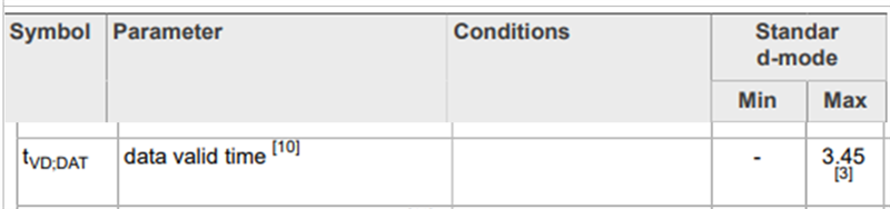

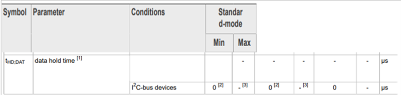

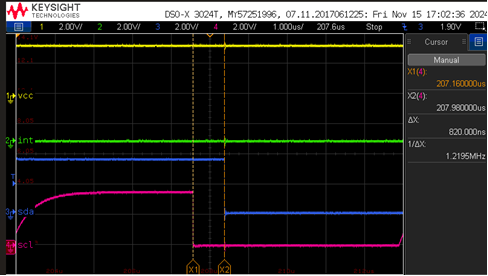

Hi Team,
Customer use TMAG5273A1 and found they cannot access I2C for different D/C units.
As feedback, the D/C 2340 (Rev. B) can work fine but using D/C 2415 (Rev A0), the I2C cannot work.
After swap test, the issue follow up with IC.
May I know if the default I2C address was changed?
Thanks.
