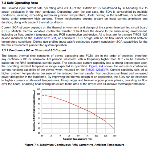

In the d/s, there's a SOA curve with ambient temp. Is there similar one for case temperature or junction temp? thanks.
Hi Brian,
We do not have a plot showing this vs junction temperature or case temperature. I would recommended you to follow the thermal guidelines in this AppNote. Section 6 shows some plots of case and junction temperature as current increases.
