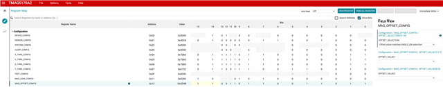

  • I think I'm inputting the bits wrong.  I am using XY angle output and want to do correcting offset for both. What i have did not improve my results.
  • Michael,
    You currently have a code of 0b01 selected for offset correction.  This will only apply the X axis correction in your case.  You will want to change this to 0b11 in order to correct both X and Y.  You'll can do a quick check after applying offset correction that:
    (MAX+MIN)/2 = 0
    Can you provide a capture plot of your results?  If you can export to a csv would be even better.
  • Can you give the code in bits I should have, I'm not getting that right.
  • Michael,
    0xCD9B should be correct.  You will see the drop downs in the "Field View" section update.  Right now you can see that for OFFSET_SELECTION it is indicating that only the X-axis is selected.  You may change the value using the drop down, by double clicking on any single bit you would like to change, or by changing the hex code all at once.

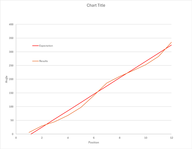

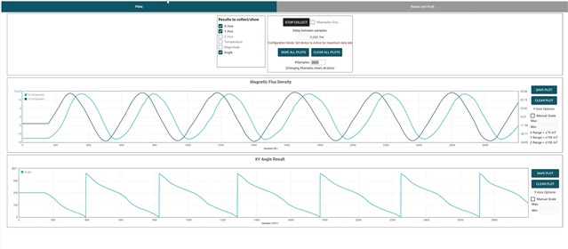

  • I was able to make those changes and then dial in the gains.  I don't think this made much of an improvement.   What would be the best way to share my setup/results?  Currently I am manually plotting 30 degree positions, see the second plot.
  • Michael,
    Is it possible to use the EVM GUI to capture a full rotation at as smooth of a rate than you can manage? In the plot for the XY magnetic field outputs you should see your sine and cosine signals.  If you can save the data from this plot, you should be able to attach it here and I could take a look.
    Scott

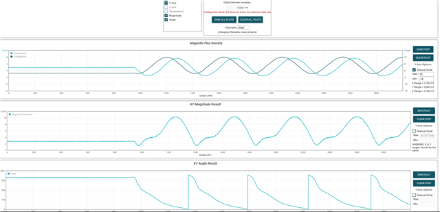

  • is this what you're looking for?  I took a little fixed speed motor and used it to turn the magnet.
  • Michael,
    It looks like in your capture that the X component ranges from about +/-13mT and the Y component from somewhere around +/-30mT.  Since the Y component is more than 2X the X component range, you will have to attenuate Y. While on the plot the amplitudes look close, there are separate vertical scaling for each component.
    If we look at the ratio of the two axes (X/Y) we get a factor of something around 0.43
    Using this I would estimate that your gain correction factor should be 0.43*1024 = 444 = 0x1BC
    The entire register write would be = 0b1000 0001 1011 1100
    This is assuming that no other correction is currently active.  If you have gain correction already enabled, then you'd have to adjust for that correction already in place.
    Scott

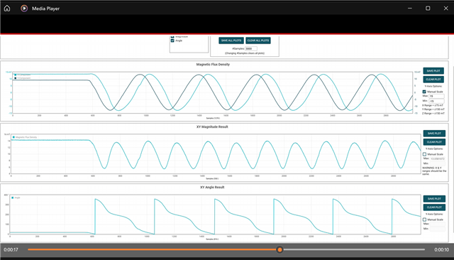

  • I took the wrong screen grab, here the xy range are pretty similar.  Should this resolve the issue?  I thin this does not resolve the issue though?
  • Michael,

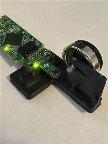

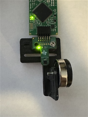

    Is your sensor rotated with respect to it's alignment with the magnet?  You should target having either the X or Y axis of the sensor orthogonal to the magnet.  It seems that your peak values of one axis do not align to the zero crossings of the other axis.
  • See below images on how the target/sensor are oriented
  • Michael,
    It looks fairly straight from the images, but the perspective can be a bit deceiving.  It looks though that the two main options for the sensor alignment to be off is if the EVM is rotated somewhat from straight since it is only connected with a single screw, or if the rotating magnet assembly has some tilt as it sits in the slot cut in the vertical edge.
    You might try adjusting the position of the EVM slightly while the motor is spinning to see if you can get the phase between sine and cosine to get closer to ideal 90 degree separation.

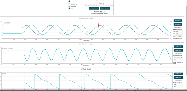

  • This is does seem a little better, I did my best to get the max/zero crossing aligned and adjusted the hardware.  I had the mag offset turned off here.
    Below I turned the magoffset on and the results are worse.  The XY Flux values shift to not center about 0, is that what should happen?  The second shot are my settings.
  • Michael,

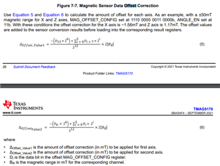

    It is possible to set mag_offset in such a way that it will make the centering worse.  You will need to adjust to your specific code to get the optimal result.  I'm not sure the exact vlue you will need, but it can be calculated following this process:
    Scott
