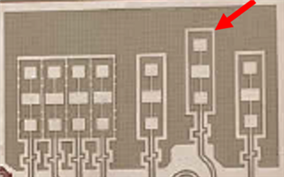

For AWR6843ISK:
What's the purpose of the copper layer surrounding the patch antenna?

The copper layer around the patches can impact on the impedance match and also the radiation pattern. It also helps in reducing current leakage into the adjacent elements as the copper layer is filled with vias.
Why not use the same technique in other cases like AWR6432???
