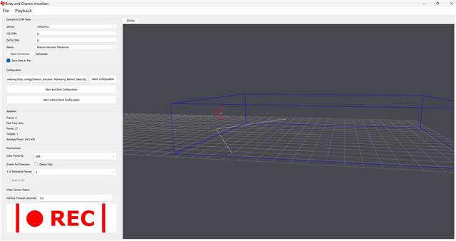

The picture below shows the visualizer data which is stuck on this and does not show any more detections.
