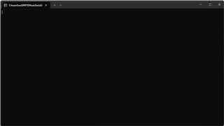

I use adcDataSPIFTDI.exe to acquire data from the IWRL6432 evaluation board.
I have checked the following document for how to acquire data:
Steps for Raw ADC Data Streaming in IWRL6432.pdf
(You can find the download page by searching the name of this PDF on Google.)
Step 15 of this document describes the following work.

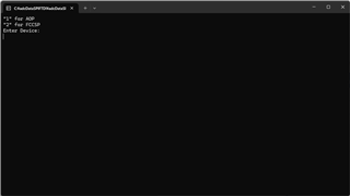

15. Open the adcDataSPIFTDI application and provide all the required parameters.
When doing this, it may take a very long time (sometimes several minutes) after launching the adcDataSPIFTDI application (adcDataSPIFTDI.exe) before the following message appears.
(During this time, the screen will remain black and nothing will be displayed.)
"1" for AOP
"2" for FCCSP
Enter Device:
I heard that it is displayed immediately on another PC.
If it takes a long time for the message to appear, what could be the reason?
What can I do to shorten it?
I would also like to know what processing is done internally from when the exe is started until the message is displayed.
(Immediately after startup: No message is displayed)
(Message screen: This may take a few minutes.)
