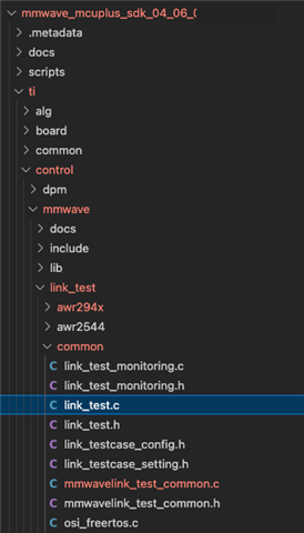

  • Hi Shawn,
    mmWave MCU Plus SDK provides Link_test application where this application gives mmWaveLink API usage reference along with CW mode usage. Please refer that to first run at your end.
    Instruction to build this application
    1. set environment by running this batch file: setenv.bat (c:/ti/mmwave_mcuplus_sdk_04_06_01_02/mmwave_mcuplus_sdk_04_06_01_02/scripts/windows)
    2. MAKE sure you have set right device within setenv.bat file (set MMWAVE_SDK_DEVICE=awr2944)
    3. switch to mmwave_mcuplus_sdk_04_06_01_02/ti/control/mmwave/link_test path in the same CMD prompt and give 'gmake all' command to build this link_test application.
    Here is code reference from link_test.c for CW mode.
        /* Set continue mode configuration */
        retVal = rlSetContModeConfig(RL_DEVICE_MAP_INTERNAL_BSS, (rlContModeCfg_t*)&contModeCfg);
        retVal = rlEnableContMode(RL_DEVICE_MAP_INTERNAL_BSS, (rlContModeEn_t*)&contModeEnable);
    Make sure if you set TxOutPowerBackoff to zero to get max output power.
    const rlContModeCfg_t contModeCfg =
        .startFreqConst = 1435384036,
        .txOutPowerBackoffCode = 0,
        .txPhaseShifter = 0,
        .digOutSampleRate = 10000,
        .hpfCornerFreq1 = 0,
        .hpfCornerFreq2 = 0,
        .rxGain = 30,
        .vcoSelect = 0x0,
        .reserved0  = 0x0
    Jitendra
