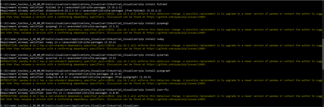

Ok installed json_fix but get Error
Went back to validate that I did the following install as outlined in requirements.txt
Error still remains. Suggestion?
Hello Lawrence.
Instead of individually installing each dependency, you can install all the required dependencies using the requirements.txt file. Can you try installing using the requirements.txt file and see if you see any issues? Also please make sure that you are using python 3.7.

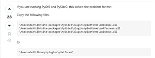

What is the error after running python gui_main.py following the latest screenshot? Is is the same qt_qpa_plugin issue? I grabbed the following from Stack Overflow, it looks like you are using anaconda; can you try this and see if it fixes the issue for you?
