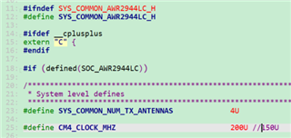

       2)“C:\ti\mmwave_mcuplus_sdk_04_06_01_02\mmwave_mcuplus_sdk_04_06_01_02\ti\common\sys_common_awr2944LC.h", set   “define CM4_CLOCK_MHZ     200U ”;

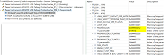

     after that, the debug show m4 execute change to 75ms, but if I set R5 CLI  framePeriodicity =75ms:"frameCfg 0 5 64 0 512 75 1 0",or a little longer 80ms "frameCfg 0 5 64 0 512 80 1 0" , it cannot running, show "HWA_localRamErrorISR"
      It needs me to set back R5 CLI  framePeriodicity =100ms:"frameCfg 0 5 64 0 512 100 1 0", M4 running normally。
