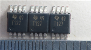

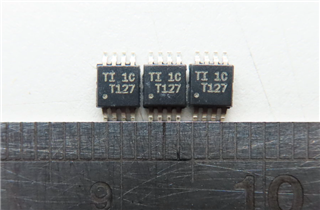

our QC has found there are 2 diff. marking for TMP75AIDGKR, one with TI logo, but our QC record are without TI logo marking on chips. and there is no PCN for marking change information, pls kindly help to check thanks!

Hi Vidianna,
Depending on the assembly site for TMP75AIDGKR, the marking could have the TI logo or the letters TI. What is important is the next 2 digits that pertain to year-month date code and the device code at the bottom.
