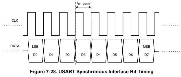

Hello Experts,
My customer has question as follows. Would you answer it, please?
1. A following figure is for PGA460 side or Host side?
2. Would you provide AC characteristics such as setup/hold time, delay time and so on, please?
Fujiwara
  • Hello Fujiwara,
      1. The capture shown above is for the PGA460 device side.
      1. These specifications are not something that was characterized on the PGA460 because the UART interface standard does not define these specifications for standard UART operation since it relies on start/stop bits along with timing of the specific baud rate. Synchronous UART on the PGA460 is mainly used to extract raw data from the PGA460 and not for use as the standard communication method with the sensor. In this mode the PGA460 is the only one providing data while the host MCU simply provides a clock input to the device at 8MHz in order to extract the raw data.

  • Hello Isaac,
    Customer checked EVM and provided a following waveform. It seems that data is sampled by rising edge and data is shifted by falling edge. So it is opposite, compared with datasheet. Customer has changed a data sampling timing to falling edge, but it did not communicate. Would you clarify which one is correct, please?
    * Note that it seems noisy waveform but it does not care of this topic.
    * yellow: SCLK, Green: RXD, Magenta: TXD

  • Hello Fujiwara,
    I checked this on the EVM and it doesn't matter if I sample on the rising or the falling edge while the shift happens on the opposite of what I selected for the sampling. What I did notice was that the data has different formats depending on what selection is made.
    Such as when I did the bandpass filter output the data was in 2's complement but when I did the LP filter output the data just good as it was. I don't have any information the AC timing I will have to check with the team and get back to you.
