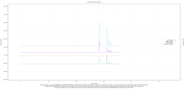

We have three coils arranged in such a setup. In the middle of it a copper rod is inserted. We use this setup to measure the thickness of the rod. It works surprisingly well.
On to our issue: When the rod is cut in half (lengthwise) or placed off-center, we observe an issue that looks like an internal integer overflow or something similar happening:
This issue only seems to appear on the coil that is farthest from the copper. Interestingly, the distance between the coil and the copper in this scenario is in the same ballpark as the diameter of the coil.

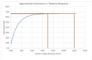

We wonder if this is something that can be resolved via config, or if this is a design error. I played a bit with your LDC Calculator Tool and came to the conclusion that the SNR is really low in this scenario because we're almost in the flat part of the curve. This might be related to the observed issue and is something we want to fix in the upcoming version. However, this is still something we'd like to understand before proceeding.
This is the tool's output when entering our worst case parameters. This might be related to the wrap around.
  • I want to add that deglitch is set accordingly.
  • Tim,
    The sensing distance that gives the best resolution is about 3% to 30% of the sense coil diameter. This would be the steepest part of your curve.
    You can sense up to 50% of the coil diameter, but with decreased resolution.  This would correspond to a separation distance that goes up to the beginning of the major "bend" in the curve.
    Some applications to determine only the presence of the target, but no other info, can work at up to 100% of the coil diameter. I'm guessing this corresponds to the part of your curve just before it flattens out.

  • Tim,
    One thing I forgot to mention...
    When we talk about resolution and distance, the implicit assumption is the target is a flat conductor at least as big as the sense coil.
    I believe the equations used in the tool may be based on an infinitely large, flat target.
    John
  • Thanks a lot for that reply! I was already aware of most of the linked documents. It still helped me nevertheless.
    This image shows the result of our mapping between rod thickness and the measured output. It is already quite good if one considers that we're currently 8-12mm from the sensor away (depending on the rod distance).
    Everything you said so far points us in the direction that we should spend some time to test what happens with decreased distance and increased coil size.
    I do have on more question though: since the rod is a long rectangle when seen from the side, shouldn't a racetrack coil be beneficial here? The calculation tool doesn't show any improvement even though I expected one. This might be due to the fact that the copper surface is calculated as a infinitely large flat surface?
  • Tim,
    As a guess, I'd say a racetrack coil would be a good way to increase the coil area while (perhaps) keeping the height closer to the height of the rod.
    The tool doesn't show any improvement because it is assuming the target geometry mentioned in my last post.
    John

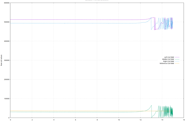

  • Ok, we got some news. See the following image:
    We can now explain the wrapping, but we don't know why it happens. For this experiment I placed the three wrapping coils next to one another on a desk. Then I took a copper rod and slowly got closer. As you can see, the line in all three cases increases, until it suddenly jumps down before increasing again. This happens multiple times. The measurement stopped when we received amplitude errors at the end where the distance was almost 0. Samples with errors are not plotted by our tool, so this noise here is wrapping.
    I think we're doing something wrong here. Your application notes always showed scenarios with distances as low as 2mm where the metal object is moved horizontally. While the test in the image was a vertical test, we also performed horizontal tests with the same results.
    I think there has to be something wrong with our config parameters. But we checked everything that we could think of.

  • One thing we do wonder ist why are the 0 and 1 coil at a base value of 500.000, while the other two are at a base value of around 4000. Their range before wrapping is identical and MUCH lower to the difference in these two. All four coils lie next to each other on the desk. Even the cables are about the same length.
  • Tim,
    It sounds like the coils, connections, and device settings are pretty much identical.
    I think the next step would be to carefully measure the sensor waveforms for comparison at the base condition.
    Look at DC, frequency, waveform shape and pk-to-peak voltages.
    These devices are really just weird data converters, so this starts the troubleshooting by looking at the inputs.

  • John, we got it working!
    This is the pendant to the previous image with the awful wrapping - now without.
    The issue was our fault, kind of. But so deep down, we completely missed it. The I2C peripheral was tasked to read the two 16-bit variables from the LDC. If one would see these two 16 bit variables as b3 b2 b1 b0 than only b3 and b1 were read correctly. b2 and b0 were random variables from the LDC's memory, hence the offset. But since we didn't look at the peripherals code and b3 with the status registers was the correct one, this issue went completely unnoticed. Yesterday when we connected an oscilloscope to the I2C bus we had an a-ha moment and started debugging the peripheral. And as you can see, we found the issue! This not only fixed the wrap around issue, but also a quantization bug be noticed.
    Thanks again for your time and effort, this was very appreciated!
