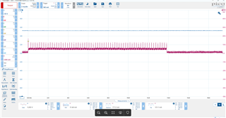

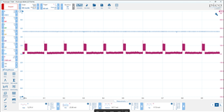

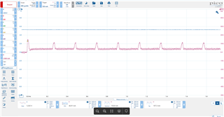

We have been measuring current consumption on our IWRL6432 custom board.
The first chirp in each frame has around 50mA higher peak current consumption than the other chirps in the frames.
Why is that?
We have tried other configs but we still se the current spike in the first chirp of the frame.
Below are measurements(red graphs) of the current consumption for the IWRL6432 AOP when chirping in different time resolutions.
The chirp config in this case is:
sensorStop 0
chirpComnCfg 8 0 0 128 1 15 1
chirpTimingCfg 200 24 0 25 61
channelCfg 3 3 0
frameCfg 64 0 250 1 100 0
factoryCalibCfg 0 0 40 0 0
lowPowerCfg 0
sensorStart 0 0 0 0
