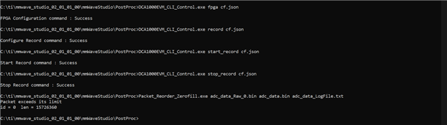

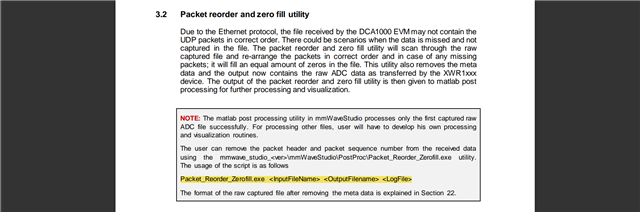

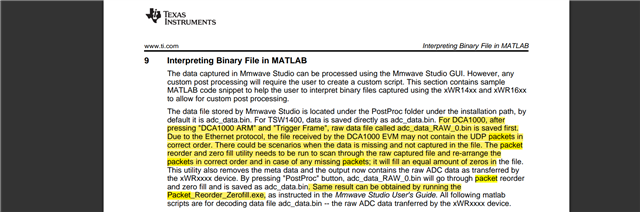

We are working on AWR1843AOP EVM with DCA1000 for adc raw data collection using DCA1000 CLI commands on windows os. We followed the TI_DCA1000EVM_CLI_Software_UserGuide.pdf document for DCA1000 CLI commands. It generated the adc_data_Raw_0.bin file but not adc_data.bin file. It is mentioned in one of TI's document that adc_data_Raw_0.bin file may not contain UDP packets in the correct order as shown in the below screenshot.
So they mentioned to pass the generated adc_data_Raw_0.bin file through Packet_Reorder_Zerofill.exe. I passed the file through packet_reorder_zerofill.exe using the command as mentioned in the below screenshot.
But, it is giving packet exceeds it's limit error. Though the generated adc_data_Raw_0.bin file is 24,255 KB. Please find the attached below screenshot for error.
Please suggest the solution for this error.
