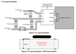

Since I am planning to have all the domains of the drive in one PCB board, and packaging size and simplicity are important, I was wondering if using a temperature sensor like ISOTMP35 and placing it close to my MOSFETs makes sense. In an application note from TI, I see that this type of sensor can also be used for GaN/SiC or Power Mosfets however, I am not sure how I would have to manage its placement with respect to this TSC MOSFET and if it is even advisable to use this sensor for such MOSFETs.

    What voltage is your MOSFET operating at, and what temperature levels are you trying to sense? For placing the ISOTMP35, it is best to place the ISOTMP35 along the isolation boundary (if possible), or route the low voltage ISOTMP35 output from the HV side to the LV side (while taking care not to violate creepage and clearance). I would try and connect the HV side of the ISOTMP35 as close as possible to your MOSFET, through a shared copper pad or plane.

    The plan is indeed to have this sensor placed on top of the isolation barrier, with its HV side on the HV domain and LV side on the LV domain of the board.
    When you say to place the sensor on a shared copper pad or plane, does that mean that I can, for example, place the sensor on the HVDC+ copper plane of the board which would connect to the Drain of the MOSFET? Or am I not understanding this correctly?
    Would having this sensor placed on such a plane lead to any issues (being that the Tsense pins of the sensor are placed directly on HV which also exhibits voltage overshoots and noise due to switching)?

    Yes you can place the HV side of the ISOTMP35 directly onto the HVDC+ copper plane which the MOSFET drain connects to as well. Doing so is the main benefit of ISOTMP35. The direct copper connection allows for much more temperature sensing accuracy and faster response time vs trying to sense through PCB material.
    Yes voltage overshoots and switching noise is a concern, so we recommend the following layout:
    The load capacitor should be 1nF, and you will need to choose the right resistor and capacitor filter values to best filter the frequencies of noise you are anticipating. But the general strategy is to filter the output to reduce noise from CMTI and EMI.
    -Alex Thompson
