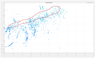

I have ppintcloud data from the setup showed in image and the pointcloud looks bit off , as the z-axis changes drastically for the same ground plane I have shared the side view(yz) and and top view xy. the person walk close then z reduces and increase as the person far away. in theory it is correct but how do I make correct and relative to ground plane. I did the required translation still the same
I did try with tilt angle trnalsate but still?
also how can I make the potincloud more dense, I was using the default config for 3D point over ethernet, the dataszie should not be problem.

  • okay, which threshold?
    and what about the big shift here in this data ? in the z-axis, why is it moving up for objects moving away on the same ground plane?

  • Hi DM,
    You can start by adjusting the CFAR threshold in the config (cfarCfg). Please note the tradeoff between the number of detected points and the number of false detections :https://e2e.ti.com/support/sensors-group/sensors/f/sensors-forum/1354918/awr1843-what-is-mean-by-cfar
    As for the shift in the z-axis, could you provide details on how you are doing the angle translation?

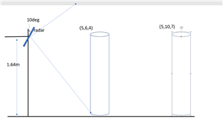

  • hi jin,
    this my logic
    % Constants
    sensor_height = 1.64; % Sensor height in meters
    inclination_angle_deg = 10; % Inclination angle in degrees
    inclination_angle_rad = deg2rad(inclination_angle_deg); % Convert to radians
    % Shift coordinates to sensor's local frame (centered at sensor position)
    z = z - sensor_height; % Adjust for sensor height
    % Rotation matrix for tilt about x-axis (inclination correction)
    rotation_matrix_x = [
    1, 0, 0;
    0, cos(inclination_angle_rad), -sin(inclination_angle_rad);
    0, sin(inclination_angle_rad), cos(inclination_angle_rad)
    % Combine x, y, z into a matrix for transformation
    coordinates = [x, y, z];
    % Apply rotation to correct inclination
    corrected_coordinates = (rotation_matrix_x * coordinates')';
    % Extract corrected x, y, z
    corrected_x = corrected_coordinates(:, 1);
    corrected_y = corrected_coordinates(:, 2);
    corrected_z = corrected_coordinates(:, 3) + sensor_height; % Adjust back to global height
    best regards,
    DM
  • Hi DM,
    Thanks for sharing. Can you check if you are seeing the same issue occurs when the sensor is mounted at 0 degrees (no tilt)?
    Also, what is the visualizer from? If it is a custom visualizer, is it based on any TI reference?

  • Hi DM,
    Thank you for the details. Assuming there is no tilt in the azimuth direction, could you try the following rotational matrix:
    [1, 0, 0;
    0, cos(elevTilt), sin(elevTilt);
    0, -sin(elevTilt), cos(elevTilt)]
    For a reference of how coordinates are rotated based on the tilt angles of the sensor, please refer to the updatePointCloud() function in the Applications Visualizer available for download in the Radar Toolbox (C:\ti\radar_toolbox_2_20_00_05\radar_toolbox_2_20_00_05\tools\visualizers\Applications_Visualizer\common\Common_Tabs\plot_3d.py).
    Regarding the config for your specific usecase, please start by defining your usecase parameters in the mmWave Sensing Estimator and modifying/testing the thresholds mentioned above as necessary.
