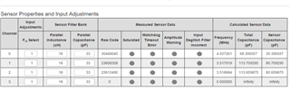

  • I would like to add more information about Deivce Status. Pls refer to the picture.
    In addition, there is a strange phenomenon that I cannot understand. I cut the sensor of evm, and use CH0, CH1 and CH2 to connect three different sensor for testing the proximity distance. When my hand moves to the sendors closely, the measured capacitances change higher. But, when I touched CH1 and CH2 sensors, the measured capacitance of CH0 become less, and the ones of CH1 and CH2 become more. How to explain this?
    You can refer to the following pictures:
    The picture is before touching CH1 and CH2 sensors
    This picture is after touching CH1 and CH2 sensors
