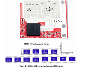

  my requirement also  running "Gesture_with_Machine_Learning demo " with AWR6843ISK EVM.
I have attached AWR6843ISK EVM mimo antenna array for reference:

  • sorry,i forget to add antenna pattern realized with two Transmit antenna in previous message and attached here.
    i have done the mapping of DOA_Input  referring above antenna pattern.
    Mani

    As for my understanding gesture application example  is created using 6843ODD demo processing chain with adding additional gesture logic.
    I have compared  src files of 6843(ODD) with gesture src files and its observed most of the changes made inside the
    "C:\ti\radar_toolbox_1_30_01_03\source\ti\examples\Gesture_Recognition\Gesture_with_Machine_Learning\src\6443\include\dopplerproc\src\dopplerprochwa.c" and inside the following function:
     1.  int32_t DPU_DopplerProcHWA_configHwa();
      2. int32_t DPU_DopplerProcHWA_configEdma()
     3.int32_t DPU_DopplerProcHWA_config()
     4.DPU_DopplerProcHWA_Handle DPU_DopplerProcHWA_init()
      5. int32_t DPU_DopplerProcHWA_process()  ---> Gesture related functions are called inside it.
    i request you to look into these function ,logics and suggest me any changes require here to make example work for all gesture conditions on AWR6843ISK?
    regards,
    Mani

    let me know changes require to make example work for all gesture conditions on AWR6843ISK?
    regards,
    mani
  • hi josh,
     Any update and my previous query and changes require to make example work for all gesture conditions on AWR6843ISK?
    regards,
    mani
  • Hi Mani,
    Sorry for the delay here. Providing all of the necessary code modifications for a large change in the demo like this is outside the scope of this forum. Have you been able to step through the code in debug mode using CCS to find out what the issue may be?
    Josh
