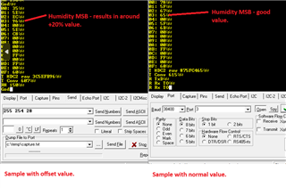

We use HDC2010 in our devices and notice constant humidity offset of around +20% on some samples.
Attached you will find prints of the sensor registers values.
Can you help as find the reason for that and solve it if possible?

    How many sensors are reading +20% high, or approximately what percentage are reading high? Are all the sensors reading high from the same lot, or are there members of the lot that have no issue? Have you exposed these offset sensors to any chemicals or very high RH & temp conditions? have these parts been exposed to pink antistatic foam? Is the +20% offset constant across different ambient humidity levels, or does the offset vary as the humidity varies (above 80%, the sensor wont output more than 100% RH of course so it wouldn't present as exactly +20%RH in that range)? Have these sensors been scratched or damaged?

    I think we can say 100% of the sensors with +20% are from one lot and 100% without that offset are from another lot.
    The sensors weren't exposed to chemicals or very hogh RH & temp conditions.
    I need to check whether these sensors were exposed to pink antistatic foam. Can you meanwhile give me information about the influence of that foam on the sensor?
    The offset is constant across different ambient humidity levels.
    The sensors weren't scratched or damaged.

    Are there any HDC2010s from the lot that is have +20% errors that are good (no large error)? Or is it a 100% failure rate within that lot?
    Given that this is isolated to a specific lot, could you please share the lot information (the label on the box)? I also think it would be wise to start the customer return process so we can get these parts on our bench and test them. The link to start this process is here: https://www.ti.com/support-quality/additional-information/customer-returns.html
    Pink foam has been shown to cause RH errors because it off-gasses a chemical which interacts with the sensing polymer. These RH errors often show as positive RH errors, but +20% is very high, and I am skeptical that this is the cause. If you can determine if the problem lot was exposed to pink foam or any chemical that the working lot was not, that would be very helpful.

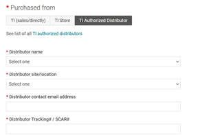

  • Hi Alex,
    I began filling the information to Create a return request but I'm not sure how to fill some information.
    Our PCB manufacturer purchase the components from this distributor - https://www.szlcsc.com/
    I was unable to find him in the list with TI authorized distributors but our men in China told us that this is the biggest distributor in China.
    So, what shall I fill in these fields:
    Martin Peevski
  • Martin,
    I will message you directly on E2E regarding how to move forward on this return. Please try and get parts from the reel and lot info from the manufacturer in China, those are critical for our debugging efforts.
