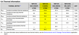

May I clarify with you what would be Tjmax of LM63?
Allan
This is an older product that doesn't have detailed thermal information in its datasheet. The thermal information should be the same as other products in the D package, such as TMP1075.
There is further information on thermal metrics in the following app note: https://www.ti.com/lit/spra953
