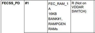

    By default power setting, FEC_PD_SRAM_CLUSTER_1 is selected to retain. Why? What does VDDAR switch mean in below table?
    Chris
  • Hey Chris,
    I will need to reach out to the design team to ask about why the first FECSS memory cluster is retained by default. As for the VDDAR, some memory clusters on the xWRL6432 are grouped together, and power switches are deployed on the corresponding SRAM power rails. If all the clusters in a group are not retained during deep sleep, switches for the group are opened, completely powering off the group, causing the memory to consume 0 µW/kB while completely powered off (no retention).

  • Kristien,
    I found below info in power app note (SWRA754)FEC_PD_SRAM_CLUSTER_1 may contain the rf firmware/frame config and need to retain.
    The FECSS Clusters #1 and #2 are handled completely by the DFP.
    Chris
