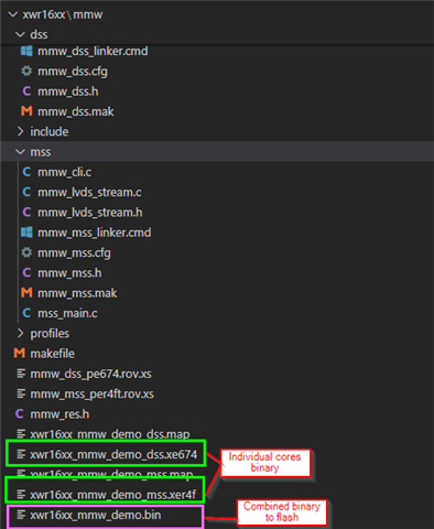

  • The .out that I'm trying at the moment is the same as the one in Radar/Debug/Radar.out. I believe I'm successfully debugging with the pins in debug mode (sop0 = 1, sop1 = 1, sop2 = 0). But then I'm turning th board off and switching to funcitonal mode (sop0 = 1, sop1 = 0, sop2 = 0) and turning the board back on and thats where I get the nerr_out led flashing. I'm not entirely sure if I need to do that last step, but I was under the impression that once a project has been debugged onto the board that I then power cycle and run it in functional mode
  • Hello Rhys,
    How are you loading it? Are you flashing it in functional mode using the uniflash tool?
    Saswat Kumar
  • im loading it through the debugger in ccs whilst in debug mode
  • Hello Rhys,
    If you are doing that what is flashed on the device?
    Loading it via CCS means you should be in functional mode as it is a RAM load, you should not reset device after that as the RAM loses its content after reset.
    1) Flash CCS debug in flashing mode SOP 5
    2) Switch to functional mode, and then load the program over CCS and then execute directly.
    Saswat Kumar

  • Hello Rhys,
    Are you loading the whole binary or only the binary outfile of that particular core?
    You should be loading the individual binary file of each generated, what you are doing currently is directly loading the combined app binary of all cores on a single core.
    Saswat Kumar
  • Hi Saswat,
    after the build step, theres only 1 binary file to choose from in the project for the load step so I'm not sure what you mean or how I would configure it to create a separate individual binaries
    regards,
    Rhys
  • Hello Rhys,
    It would look something like this:
    I have just attached the demo path, but your executables will also look something like this
    Saswat Kumar
