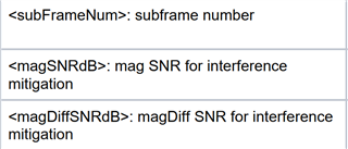

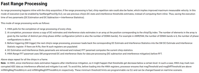

two cmd parameters as below, both have parameters related to interference suppression, i want to know what the relationship between them.
If i enable fastRangeProcCfg, does it mean intfMitigCfg cmd is disanled automatically?
