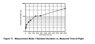

    The standard deviation of the measurements starts to go up in mode 1 once the measurements exceed the 800ns that's why the recommendation to not make measurements above 500ns exists. Below is a figure from the datasheet that shows this behavior. The standard deviation for your measurements could be much worse than this if taking such a large measurement.
    Isaac
