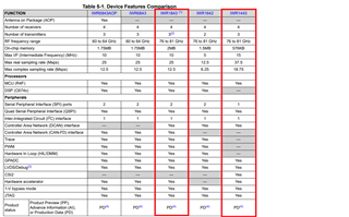

What is the difference between the two radar models, IWR1443 and IWR1843?
We are looking into your query. Please allow us a couple of days to respond.
Sharan
Hi There,
Both IWR1843 and IWR1443 are 77GHz millimeter wave radar devices. Below are the major differences between these two devices:
IWR1443 does not have additional DSP like IWR1843. Also, IWR1443 has less on chip memory. Please refer to the below table to find the differences:
