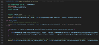

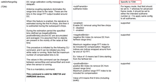

In sdk3.6.0.0 user guide, there is a CLI command called calibDcRangeSig, in sdk4.6.1.2, this cmd is specific to TDM, Is that mean that it can't be use in DDM?

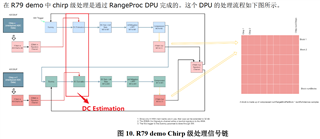

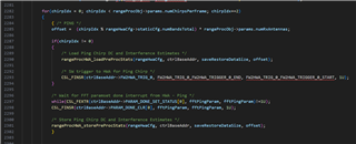

But in R79 demo(high end corner radar), rangeproc dpu already use this feature.
Here is my queations:
1. calibDcRangeSig cmd can be used in DDM?
2. If 1 is yes, is this feature enabled by default? because i can't find the cmd in the profile(profile_3d_3Azim_1ElevTx_DDMA_awr2944_highRangeRes.cfg) location:C:\ti\mmwave_mcuplus_sdk_04_06_01_02\mmwave_mcuplus_sdk_04_06_01_02\ti\demo\awr294x\mmw\profiles\ddm_awr2944
3. If i want to disable the feature in DDM mode? what should i do?
