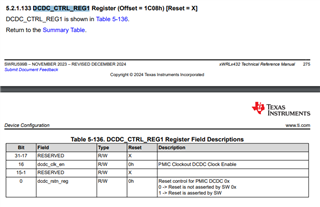

Hi Tom,
Can you look at the DCDC_CTRL_REG1 register? It looks like bit 16 enables the output. I found it in the TRM for reference.
Nate

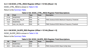

Thank you Nathan. Where does one find out how to set the PMIC_CLKOUT frequency?
Hello Tom.
Looks like you can use these registers to set the max and minimum frequency and the frequency slope.
You can use the HW_WR_REG32 function to write to these register addresses.
