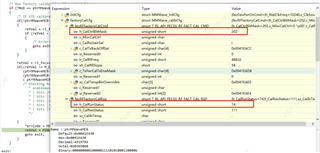

My customer made own AWRL1432 board, but failed with MMWave_factoryCalibConfig.
The return value of rl_fecssRfFactoryCal is 0, but failed in below if code.
MMWave_factoryCalibConfig()
It seems some calibration is not PASS. ptrMMWaveMCB->factoryCalCfg.fecRFFactoryCalRsp.h_CalRunStatus is 74 which is not same as 202(0xCAU).
Same code can work ok on AWRL1432 ES2.0 EVM.
Customer has checked the 1.2V and 1.8V power rail and didn't see any drop during test.
Would you pls kindly advise what may cause the problem?
